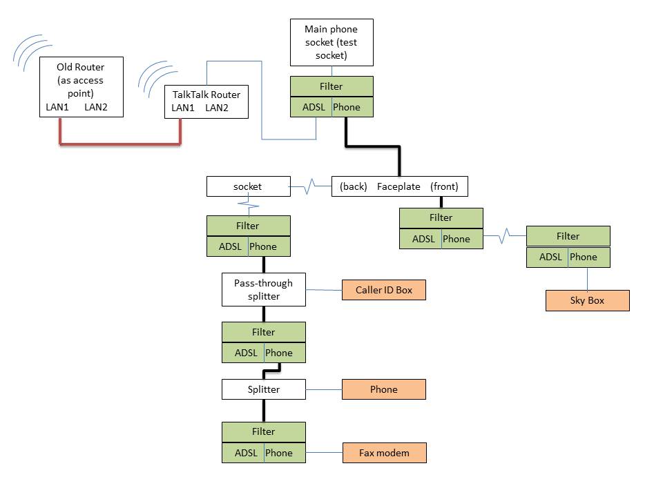

I'm having ongoing issues with my home broadband (from TalkTalk). Before I ring them up (again) and end up talking to a script monkey (again), possibly ending up with a chargeable home visit, I'll ask here first to check all's well our end :)
This is the current setup - this has been rock solid stable for 3 weeks at 2Mb (which is fine as it's what I was told to expect - before that we had a flaky 512k which suddenly went to a stable 2Mb after a "fault" (read: upgrade that they forgot to tell us about:rolleyes:)) until Saturday when the DSL started dropping out sporadically, and now it won't connect at all. Odd thing is that if you make a call on the landline, it does connect, and work for a few minutes, which is maddening if you're ringing their helpdesk as it's, well, working at the time.

The old router (access point) is there because a couple of our computermabobs won't support WPA2 and the TalkTalk router won't support anything else - it's on a different channel and ssid and the wireless bits are working fine.
I've plugged a filter straight in the test socket as the numpty who lived in the house before (partner's ex) had wired an extension into the back of the faceplate, which obviously needs filtering.
Long story short - their end or mine?
Edited by BatchFile
It looks like you've may have too many filters on there. You have two filters inline to your sky box. I think I'm right in thinking that you only need one filter for each mains extension which would make the ones after the splitters redundant. I think you only need 2 filters one on the front of the faceplate to the sky box and one on the rear to the rest of the phone sockets in the house.
by the looks of that you need 1 splitter in the main socket. Adsl plugs into its sockets and everything else plugs into the other side (a filtered faceplate may help that way if the old junk is wired direct into the socket you can krone it into the back of the faceplate )
As everyone else has said, you don't need all those filters. If the phone (on the master socket) comes out and goes into extensions prefiltered, you don't need to filter it on the extensions as well, however, all those filters won't effect your Broadband as you're ADSL is into the master socket filter anyway.
The best thing to do to ensure it's not you is (as I think you've already muted at doing but...) to remove all your extensions and telephony equipment so that you're left with just your master socket. As you have a test socket behind, plug a filter into this and then plug in your ADSL router directly to it. Just the router on it's own and nothing else into the router (not that taking a LAN feed actually would compromise it, but back to basics here). Then, using one of the machines that will connect using WPA2, connect up and see what your modem is doing ..
If it doesn't connect up this way, then basically the fault can't be at your end unless it's TalkTalk's router that's not working, in which case the charge would be down to them anyway.

Start with only the router and a filter in the master socket. No phones. For at least 24 hours. Monitor your speed and if possible, check the sync and noise/atten on the router page making a note of these.
It is also worth noting that as your connection has been intermittent it will not be stable or at it's maximum speed for 5-10 days as the exchange sorts it's self out.
Also worth trying both a couple of new filters and a new/different router.

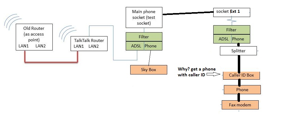

You have way to many filters there. Plug in 1 filter to your main socket, pop 1 telephone and your router into that filter. if all this works fine then there is no problem.
