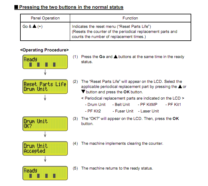

Achandler Posted March 11, 2011 Report Posted March 11, 2011 Cant you just go into the service menu and reset the life counter? Thats what you do with the drum units. 1
plexer Posted March 11, 2011 Report Posted March 11, 2011 http://support.brother.co.th/Manual/Printer/SM4040-4070CDW.pdf Ben 1
plexer Posted March 11, 2011 Report Posted March 11, 2011 From the parts life menu. See attached. Ben
plexer Posted March 11, 2011 Report Posted March 11, 2011 Just press go and up as indicated and then use the up and down buttons to scroll through. Just looked on my 4040 and it's the same. Ben
