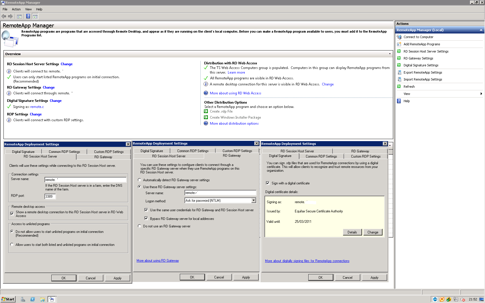

Have you Digitally Signed the .rdp Files?

Ok I'm getting a little confused as to what to put where:
The TMG rule appears sound.
DO I ned to configure RDS, etc on the TMG server - if so what with?
What do I configure on the RDS Server that will be hosting the apps?
User > Web > TMG -> RDS should be the path
Internally its all fine
Externally the SSLs are now sorted and working
What do I configure for the RD Session Host, the RD Gateway on both the TMG and the RDS servers?
