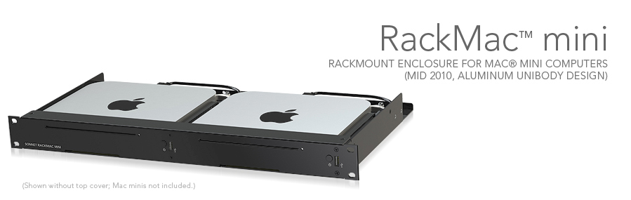

    A RackMac mini might be another option (along with one or two Mac mini's).
    Quote Originally Posted by Exos View Post
    Alternatively can can use a cumbersome Mac Pro (not rack mountable) or look at ActiveStorage's alternative the ActiveSAN.
    The ActiveSAN is an xSAN MDC which runs Linux and StorNext FS - so definitely not an xServe replacement.
