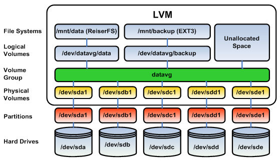

  12. #8
    powdarrmonkey's Avatar
    Join Date
    Feb 2008
    Location
    Alcester, Warwickshire
    4,856
    Thank Post
    412
    Thanked 776 Times in 649 Posts
    Rep Power
    170
    Quote Originally Posted by dhicks View Post
    I'm confused! I've only ever used it for the opposite - taking one large volume (generally a software RAID 5 array) and chopping it up in to a bunch of smaller volumes, generally for use as virtual machine drives.
    Here, this might help visualise it better:
    shamelessly cribbed from Linux Document: LVM - Logical Volume Manager - AIX 5.3
