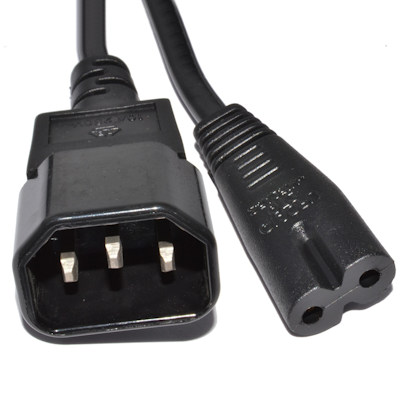

    Hi there,
    Does anyone know if its possible to convert a Figure of 8 plug (IEC C7) to a Kettle Lead type plug (IEC C13).
    I ask as one of our projectors has failed, and it has a figure of 8 lead. We have a spare projector, but it requires a kettle lead. So instead of pulling out all the cables I wondered if there was a way to do this.
    Previously we have used similar converters from Maplin to convert a Figure of 8 to a clover leaf.
    However I can;t find any on the internet, so I am assuming its not possible (or even safe!).

    Edit: No as the figure 8 does not have ground, I read it backwards hence the info below.
    You can do it the other way though:
    Leads Direct - Mains leads and cables
    2m IEC C14 plug to IEC C7 ( Figure of Eight, Calculator/Radio style) 2C14-C7 £3.49 inc VAT (£3.03 ex VAT)

    If the procjector has a kettle lead then it is most likey a class I device and needs a earth. It would fail a PAT test if the earth isn't connected and could potentially be dangerous.
